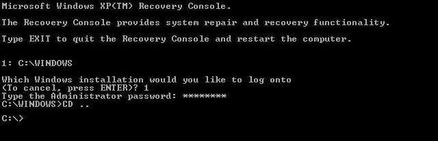

  • Type command cd.. till you get to root category, i mean - C: not C:\WINDOWS
  • Now that we are at C: we can begin the process of repairing the operating system.

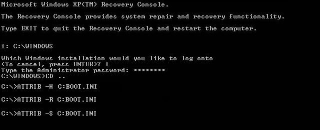

  • It should look like this

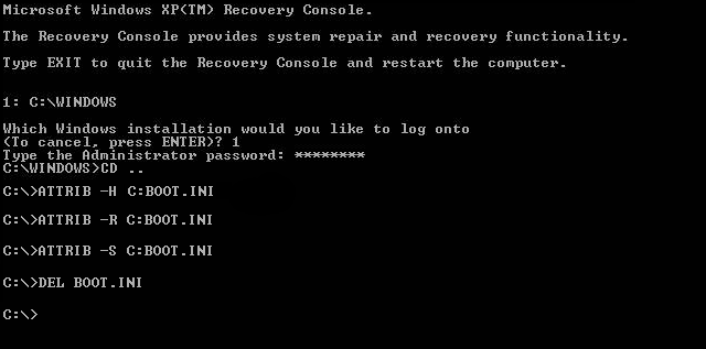

  • Now that weíve modified the attributes for the BOOT.INI file, itís up for deletion.
  • Type next command
DEL BOOT.INI

Wait, do I literally type *First steps* COMMAND CD or what? I'm not a typical Command Prompt User. Sorry, Haha.
"type command cd.. till you get to root category..."
I looked at that screenshot, and it says C:\WINDOWS>CD, and you said NOT to type C:\WINDOWS. I haven't tried this yet, for fear I'll screw up, and I figure it's not worth acting like I know what I'm doing.

Just type cd.. without any prefix.
It's like this, your in Windows\system32 folder.
C:\WINDOWS\system32
Now, it you type cd.. and hit Enter - you'll get to
C:\WINDOWS\
If you type it one more.
C:\
That's root folder Smile

tried for a bit to get the pass, got it. BUT. I type cd.. and it says invalid command. : / wont progress till you respond, j.i.c lol

You have to put two dots Big Grin cd..
